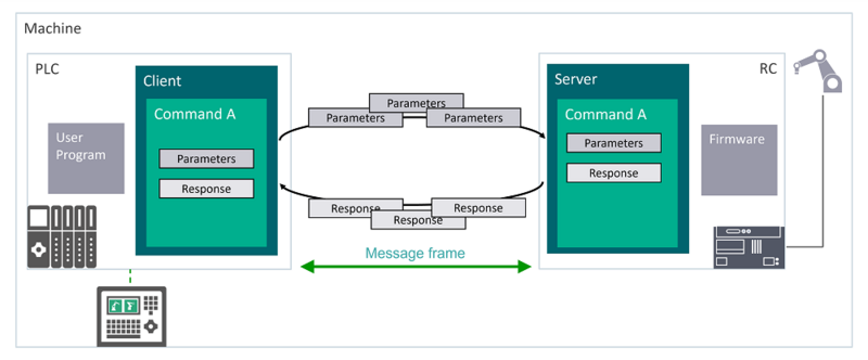

Implementation
The interface between PLC and RC is based on a client-server model, implementing remote procedure call mechanisms. The PLC (client) invokes server functions by sending command messages and its corresponding arguments (parameters) to the RC (server). The RC executes the function and in turn sends back command-specific response messages.
The client has the task of sending commands to the server and receiving one or multiple responses. Arguments and responses of different commands may vary. Therefore, the client must update commands and send an updated argument list to the server. Likewise, the server sends multiple response messages to inform the client of the current function execution state (busy, active, done) and other response data.
The interface communication between PLC and RC can be realized via PROFINET (isochronous mode is not necessary), while the RC functions as IO-Device and the PLC as IO-Controller. However, the realization is also be possible on other common fieldbuses.
